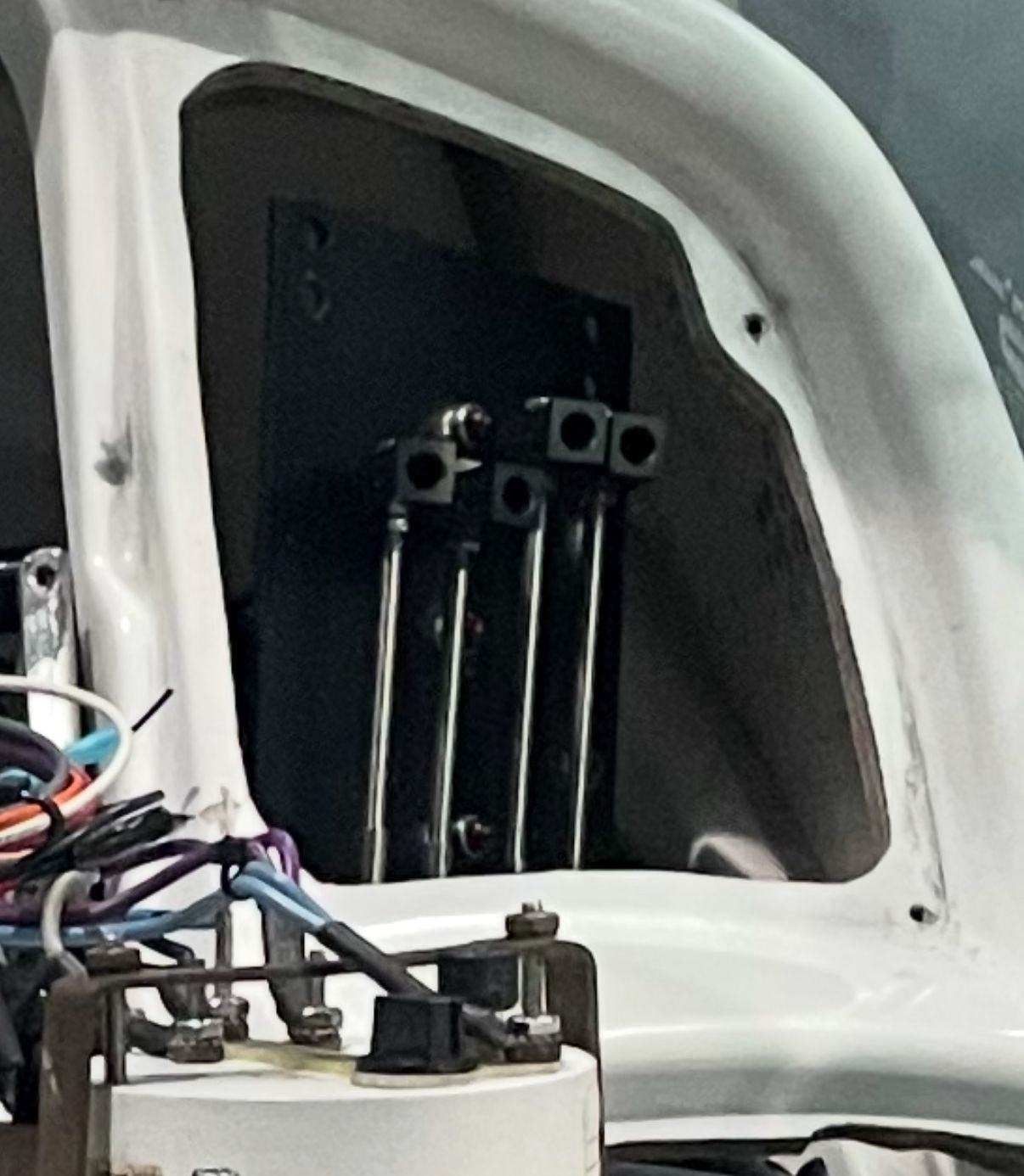

If you pull it apart you just have to be careful that you don’t lose the little springs on the indicators

Well hell...lol. Painting in place is just as big of a pain but less headache so thats that I guess. The others I should be able to 3d print or just paint. Thanks fellas!

[img alt="If you are going to paint in place don’t bother loosening the dash panel
This is the piece connected to the dash panel
The plate with the indicators bolts to the back of the bezel and springs hold the indicators in the guard
You can’t loosen the bezel up without taking this back piece off
Not sure if this makes sense but hope it helps"]https://cimg7.ibsrv.net/gimg/www.offshoreonly.com-vbulletin/1206x1386/img_4790_f54adcd51d2444faeabc227d059849ac16579b69. jpeg[/img]
If you are going to paint in place don’t bother loosening the dash panel This is the piece connected to the dash panel The plate with the indicators bolts to the back of the bezel and springs hold the indicators in the card You can’t loosen the bezel up without taking this back piece off Not sure if this makes sense but hope it helps
