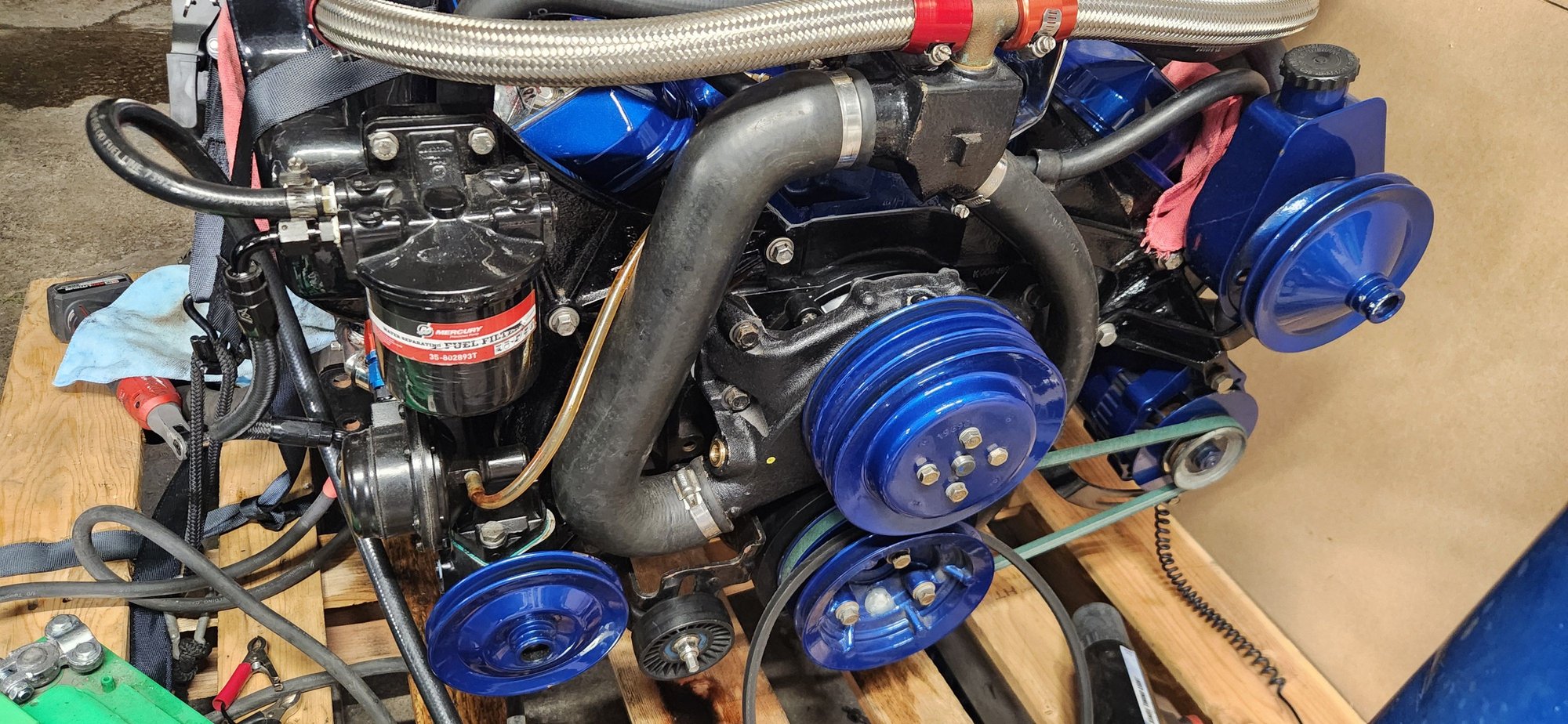

I want to run the engine on this stand before I install in the boat to make sure all is good.
I have sea pump belt off in pic but is back on now.
I dont want to run power steering pump because its not hooked to anything on high psi side and will leak everywhere.
I need the motor's water pump (on the block in front of timing chain) to run to circulate the water thru the block but cant do that because its on the same pulley as the power steering.
So Im trying to figure out how to do so or if Im missing something really obvious.
Hopefully this helps and sorry for any confusion. Been a long busy weekend.

as mentioned connect return to supply and make a loop.

U need back pressure on the line though right? As in just cant fees high psi line into the return?
U need back pressure on the line though right? As in just cant feed high psi line into the return?
496BB,
Nope. No back pressure needed. Just let the pump do its thing and let the fluid circulate.
If it were as easy as dropping a belt, that would be the obvious choice. But you can't, so the next best option is to just connect the two hoses.

This pic your high psi line ? If so, then it’s a flare fitting you can just slide back the nut and probably just slide over your return rubber hose and clamp. If not same size you have options to make things fit/connect.
And no, no back psi needed. Connect high to return.

Posts: 61
Easy enuff. Thx!
