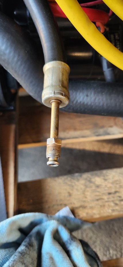

Return is just a 3/8 rubber oil hose.
psi linewill haveeither flare fitting or saginaw fitting at it’s end. Take a pic and show us, if you don’t know what either look like.

U need back pressure on the line though right? As in just cant fees high psi line into the return?
U need back pressure on the line though right? As in just cant feed high psi line into the return?
