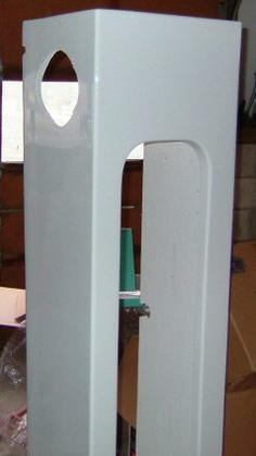

I was going to use Awlgrip, but wound up with Interthane Plus. It can also be rolled or sprayed. I tried brushing a few small parts but it left brush marks. I then sprayed them and they came out great. Super glossy!
One piece of advise, make sure you de-greese/wax before you sand, and make sure everything is clean, clean, clean! Any little particle that lands on the wet paint will be noticable.
I also thinned it more than recomended because my gun did not have the right size tip.
