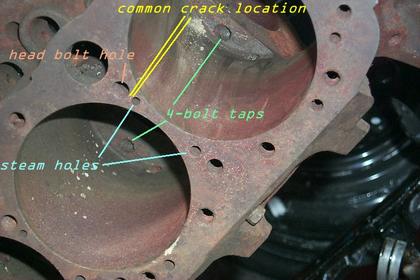

A couple of you mentioned 406. I assume you're thinking of using the siemesed bore 400 SBC block. I don't recommend this with a salt water open cooling system. The steam holes are too small and would be easily clogged with corrosion. They can NOT be drilled oversize either because of their proximity to the head-bolt hole. Also using this block would require you to have your heads drilled with steam holes. Using the 400 small block IMHO would not gain you enough extra power over the 383 to justify the added cost, not to mention your reliability would be down the drain. If you want to stick with a small block I suggest the 383 with 5.7 rods. Go to the extra expense and opt for the steel crank I have built many of both motors and there is no discernable power difference when built right.
Roby
