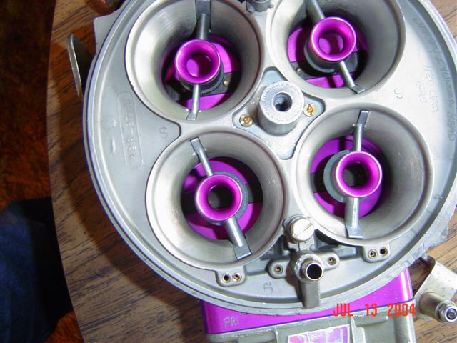

They're baaaaaaack . Sent tuesday....recieved back tuesday...not bad.
Now lets hope there's a difference. One noticable difference is more restrictive primary boosters. Next lost the j tube vents. They claimed they caused a reduced barametric pressure in the bowls.

that ought to cover those holes
