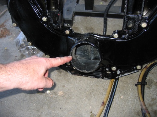

Some of my ??? where regarding the fit of the TRS inner transome plate to the Konrad gimbal. I opted to not machine the exhaust port on the transom assembly as I have no silent choice. The concern I had was if the port on the TRS unit would bind against the Gimbal housing and prevent a good seal on the transom. I checked and measure but found that I could get the gap down to 2". The transom is 2.25" thick! No problem... But I still checked.

Some more of the exhaust port.

So you may have noticed the wires back in post 12. Those are for the trim, which I'm not using because I have mechanical indicators. If you ARE using these then you need to either figure out how to get the out of your exhaust port or make sure to order your drives with the wires routed elsewhere. If you have the silent choice Konrad will have these come through in a different spot but you MUST tell them.
