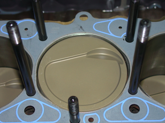

Default Re: How Much HP??
I just re-read your post,are you sure its 9-1? did pistons have flat tops or dish?my 540 pistons were J/E racing(not srp's) specifically for blower app and they have dish as pictured,Smitty

Old 06-15-2005 | 06:21 PM
Joined: Apr 2004
Posts: 196
From: Arizona
I am not sure exactly what the pistons are, the specs I was given was that they are supposed to be 9.1:1. I will know more when they are yanked and I inspect them.
