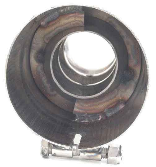

I really need to add some mufflers because its way too loud. I know as soon as I do the reversion will just get worse. I'm looking into the GGB Cyclones.
