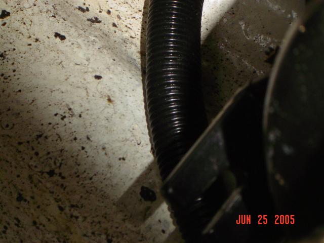

Couldn't get my fat a$$ back there but though the magic of digital photography I found this...

BTW it's white paint NOT white with black speckles Guess the ol' engine will be on the end of a chain again this week
