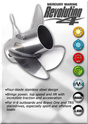

24 P... The big cups will lift you up and out..and this thing digs in...it's an offshore prop as you may know and tuned for top end. It loves TRS drives too.

You need 4 blades no question. 3 blade props slip too much on a big, heavy boat. 24 may be too much pitch, but you'll be close.

YEs, 4B props are the way to go with your set up. You simply need the additional blade to help carry the length and weight of the boat.
