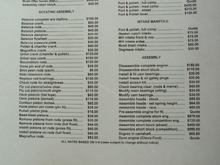

Originally Posted by electrical1
well i just got some of the motor spec's from my motor builder was wondering if you guys can let me know what you think and if it was worth it (50,000 for both, 25000 ea.).
$50,000 seems like an aweful lot of money for what you have there. Here's a labor/pricing sheet of a local, very reputable machine shop in my area that has been in business for about 20 years or so. This price sheet lists cost of all the machining operations in detail. All labor is based on a $60 per hour labor rate and they have "state of the art" equipment.
They do a lot of edurance engines, and they know what it takes to properly machine an engine destined for the hi-perf offshore marine environment---without any hype. Compare it to what you have paid for, the parts you have, and then ask yourself if you think you may have paid too much.
I will post the labor sheet in two segments in hopes that it is legible. Just click on either one and it will enlarge it for you.
Attached Thumbnails motor spec's please evaluate-enginecomp-005.jpg   motor spec's please evaluate-enginecomp-006.jpg
