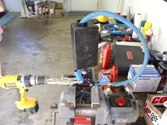

When I ran my powerstrerring pump free flowing [no restriction]there was no pressure.When I ran it thru the filter and cooler still free flowing back into the reservoir it had 150psi.I could pinch the hose and make more psi and if I dead head [pinched]it made 1500 and twisted my arm with the drill
With engine running it had 250psi which was going thru the hoses and the helm also. Would this not be a restriction??
Rob
Free flowing zero pressure
http://www.putfile.com/media.php?n=pump-002
Flowing thru the Cooler & Filter 150psi
http://www.putfile.com/media.php?n=pump-011
With engine running it had 250psi which was going thru the hoses and the helm also. Would this not be a restriction??Rob
Rob
