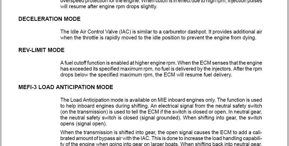

The above is all correct Im guessing that they are mpi motors if the above checks out ok also check the iac ( idle air control if that is bad it will seem to be doing what you are saying ) # one to check as mentioned above is the fuel filter and fuel press...and then if it has a vst (vapor sep ) check the float and needle and seat ...also you didnt mention if the cond of the plugs and if running rich lean ect....
Anything off of idle, the IAC has no effect even if it's defective.

Default Re: Mercruiser Engine Problem
oh ok sorry guess im wrong that if its stuck open its not allowing extra air in, im sorry guess im wrong and that wont effect anyting out of idle or that if its bad the motor wont go into limp home/ guiardian mode sorry im wrong
oh ps call merc tech and tell them also because they dont relize that
sorry didnt mean to get pissy but just because something when working properly only effects idle doesnt mean that when its not working properly it doesnt effect other things ie the iac. been doing this a longggg time and ill be the first to admit that im not always right but ..........

this is from the merc tech manual
I know I know the iac does nothing out of idle
