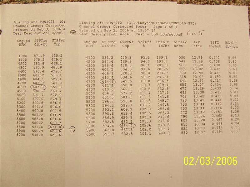

Can you post the engine build and dyno sheet ? We need to make sure that the dyno report is reasonable so we can come to a closer guess on what your actual power is when all the accessories are added.

Here are the dyno sheets.
