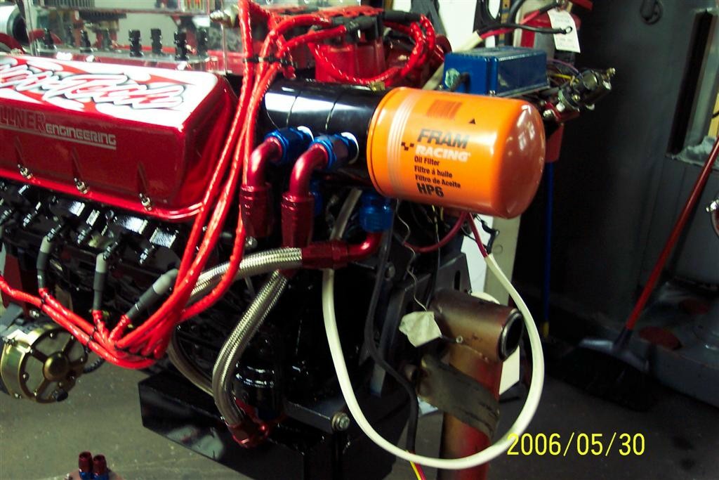

Dean Gellner Engineering recommends using a stud with a nut.. that way you have two forces of keeping the header tight.
