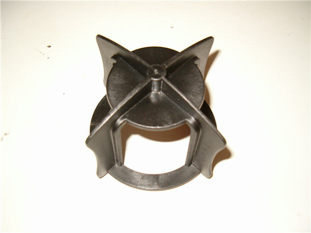

Didn't Mercruiser have a problem with reversion on the 454 and 502's with stock camshaft and thru-hull exhaust (there is a sevice bulletin on this)? Their recommended solution for this is the exhaust resonators.
Still do not know if these work.
