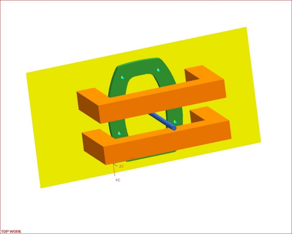

Here's the best I could do on short notice.
Yellow is outside of the boat / Transome.
Orange is your 4X4's, you may have to build supports
running to the ground to keep it all supported.
Blue rod represents your chain running in and through the transome assembly bolted on the inside of the boat.
This way you pull evenly from the center of the assembly.
Your jack will sit against the 4X4's putting the stress evenly on the transome, You may put bigger feet on them if your worried about spreading the load . But this works well with out sweating your arse of and all the cussing.
Keep the two longer 4x4's as short as you can so the don't bend when you start putting a load on them with the jack.
Cougarman
