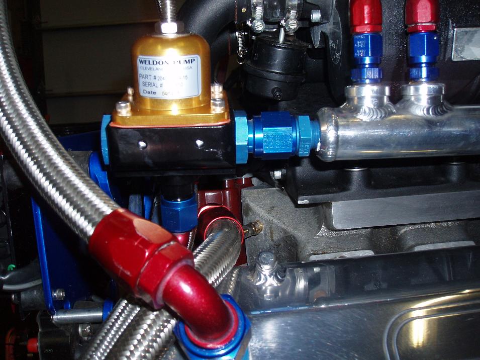

scrap the electric pump. keep it as a back up and go to a mechanical that actual was designed for the conditions we high per formance boaters put these engines thru.
and with out a doubt use a return style regulator.
install the reg. after the fuel log, this way if it faila you end up with too much fuel instead of a mess.
the pump is a vailbale from cv products. (it was designed and is used in nascar.)
the regulator is weldon's.
