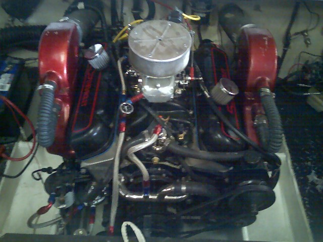

I am running almost the exact same engine right now.
I am running a mkIV block 7.4l with gm perf aluminum heads 110cc with 1.7 rockers zz502/502 cam wich is the same as what you have,zz502/502 intake. The only thing i have diff is i am running 10.7:1 compression with the srp 10:1 forged pistons and a BG 825 carb.
If i use the 20hp per mph to figure my hp gains i picked up 200hp from the stock 330hp. I gained 10mph and still have some rpm's to find.
So if i go from that i am pushing 530hp.
I have not dynoed the engine so this is just a wag.
If that makes sense

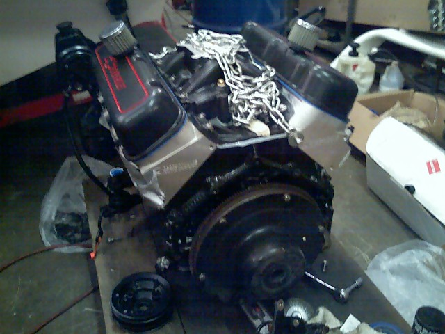

I believe the Edelbrock heads are the same as the GM perf heads.
Attached Thumbnails 454 Advice Needed-engine3.jpg   454 Advice Needed-engine5.jpg
