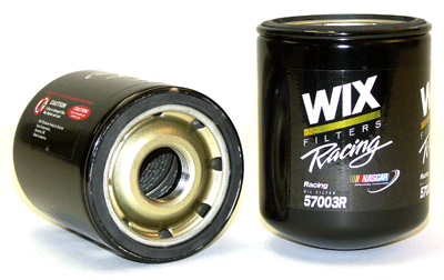

Whats the diff on a wix 57003R versus the 51222R
looks the same size
Maybe the sticker is upside down
guessing?
•Filter Bypass Relief Valve Yes
•Relief Valve Open (psi) 18-22 psi
or thread?

57003r
http://wixfilters.com/filterlookup/P...sp?Part=57003R
51222r
http://wixfilters.com/filterlookup/P...sp?Part=51222R
Not much different. Just the max flow rate. 2gpm different

Originally Posted by 07DominatorSS
57003r
51222r
prob for dry sumps
2gall per min is a bunch

Advanced Performance Oil Filters use a media (T-10) that is rated at a Frazier air flow of approximately 267 CFM and is wire-backed. The unique wire-backing provides a very stable base for a media blend of fiberglass, polyester and cellulose. This media is resistant to high temperatures and water levels in the oil that can plug standard media types. Our Advanced Performance media (T-10) is designed to provide a high positive oil flow with low restriction.
High Efficiency Endurance Oil Filters use a media (T-71) rated at a Fraizer air flow of approximately 75 CFM. This media contains a higher resin content than our Advanced Performance Filters to trap and hold smaller contaminant's and provide higher efficiency.
51222r.......T71 filter media
57003r.......T10 filter media
Everything else is the same. Except the price.

Default 57003R versus 51222R
Thanks guys i have been using the 57003R on my 600 sci that has been bumped from 620--640 hp to over 700+ by whipples reprogramming.
