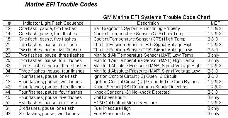

Does anyone have the code translator for a 1996 MEFI1 502 Mag. I have the LED flash unit that plugs into the ecu. ie 2 flashes means this, 3 flashes means that. 4 flashes etc. How to read the thing is what I need.
Thanks
She wont start.
Cranks very good but no go.
Ran great two weeks ago.....
