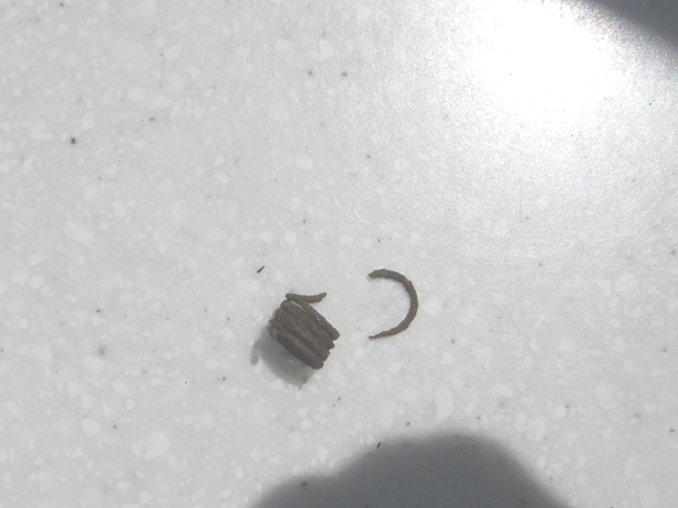

Default MSD Rust Problem Results in Starter Damage
MSD + Marine use = Junk and it breaks parts
Engines (yes two) started kicking back like timing too far advanced. Broke two starters before timing light establishes no advance cure, just total advance. I call MSD technical support and they tell me it can not happen as a loss of springs would result in retard (I think the person on the help line was retarded).
Attached is a photograph of the one remaining spring.
If you use an MSD, inspect under the cap and rotor for rust frequently. My $.02.
edb07 is offline

the carbon ball wearing is pretty common, I see it alot....
As was already suggested, I also bend the metal tab slightly so it makes better contact....

Just found the same thing with the worn carbon in the cap. I don't know what caused it but there was a lot of corrosion on the contact points inside the cap. I also discovered a bad coil, oil was leaking out. I don't know whether it was the coil, the corrosion or something else. I checked the coil on the other motor and sure enough it was leaking some oil as well.

I have been using the Accel Coil with the MSD 6AL box for years. Not that I get much run time out of my motor, but I have had a problem with the setup. It will corrode, inside the dist. I have it locked out any way, so advance isnt an issue. Using the EFI ECU to control spark advance and using a crank trigger, that made a big difference in my tach signal to the ECU.. I also use a filter cap on the 12v input to the 6AL box...
