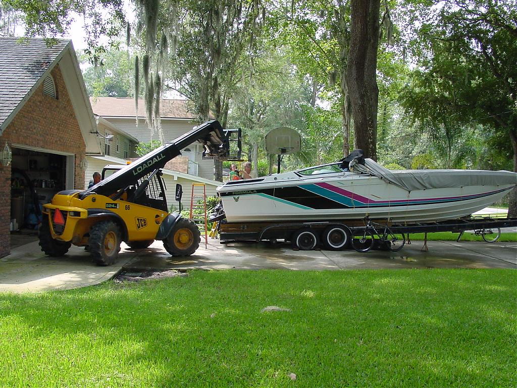

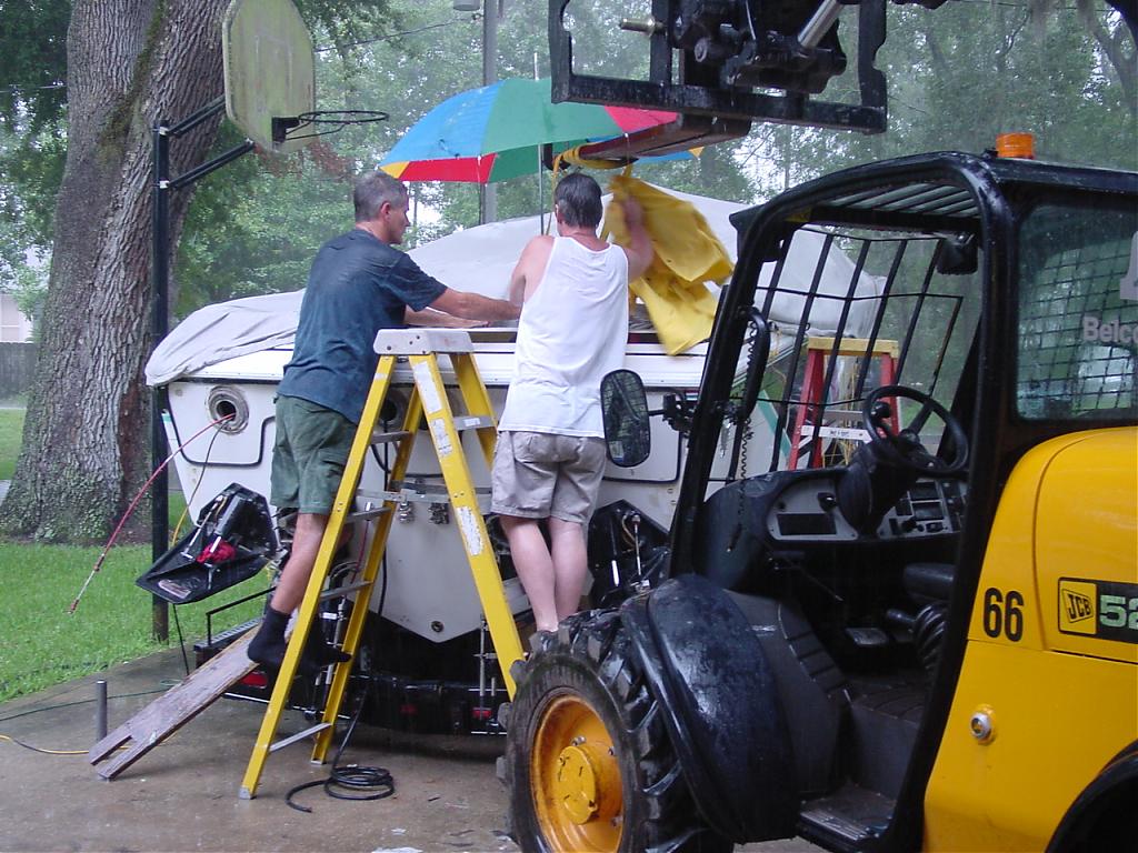

Got em in .... 3 times .... put em in ... oil cooler hit the inner plate where the internal steering mounts ..pulled them out and cut the bracket off ...put em in and oil cooler hits the steering tiller ... pull em out .. cut the tiller .... Put em back in in the rain ......
Question ..... we got the alignment close but I still want to fine tune ... Is it ok to make adjustments without taking the weight off the mounts ?
Attached Thumbnails Engine Alignment-dsc00224.jpg   Engine Alignment-dsc00227.jpg   Engine Alignment-dsc00233.jpg
