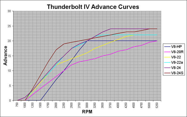

Here are the TBIV advance curves. Don't forget to add your inital timing to these figures to get total your advance.
Thanks for the curves! I wish it had the V-6 in it....
