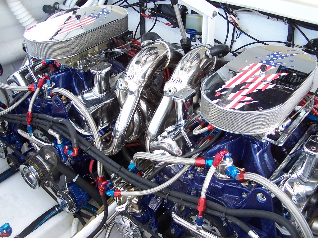

Old 11-11-2007 | 10:33 AM
  #50
Blue by You's Avatar
FIERCE ALLEGIANCE
Joined: Jun 2003
Posts: 1,207
From: West palm Beach, FL & SML VA
Originally Posted by US1 Fountain
I was under the impresion it doesn't freeze solid, but turns slushy.
I was curious so I stuck a bottle of pink antifreeze in the freezer over night. 10 hours at 0 degrees turned it into a slushy mess and expanded the bottle out. I did use the pink stuff to winterize but I also use 2 600watt xtreme heaters in the bilge. I have a lighted extention cord that I can see when it's hot so it's easy to know if power goes out. (at least at night you can) We don't get all that cold here in NC and my boat will spend most of the winter in Myrtle but with the $$$ spent this year on motor work...I'm not taking any chances. If you live where it get's cold...I suggest you do what you need to do so you're not on OSO come spring asking how to change out a cracked up motor.
