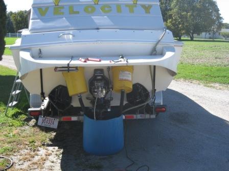

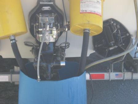

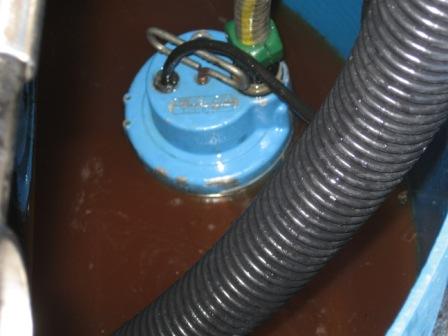

This is my contraption. Works good and you don't loose any antifreeze.
Attached Thumbnails Winterizing-img_0979.jpg   Winterizing-img_0980.jpg   Winterizing-img_0981.jpg
