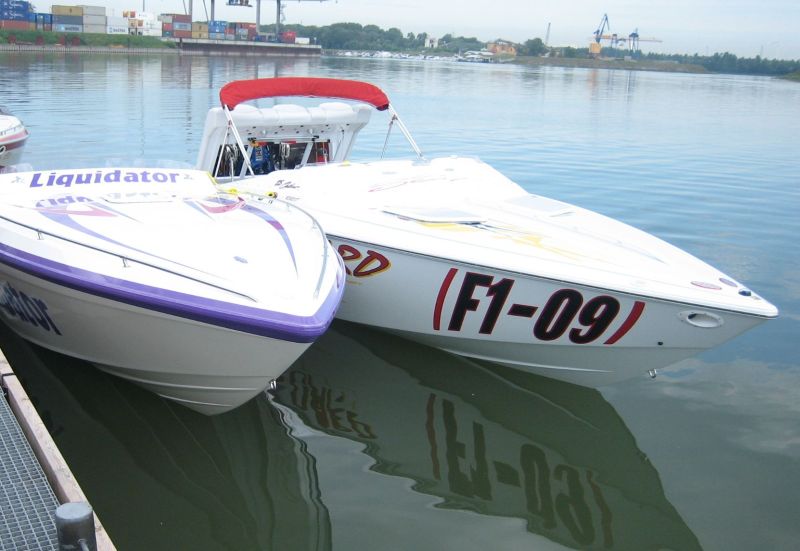

I used plexiglas and it worked really good. Do not fix it with screws. You will never get a distortion free surface that way.
1/8" plexi works really good. Cut to size and sand the edges with 100 grade. I used self adhesive backed Velcro and it is great. Attach it about 3/4" inbord from the edge and acouple of strips across the middle. Clean the surfaces with a mild solvent before to make sure they are free of grease.
The cool thing about the Velcro is that it acts as both a shock absorber and it will even out any slight uneveness in the base surface. Velcro tends to grip stronger and stronger with vibration. My mirrors have been on for a season and you can hardly pull them off. They can however be removed and refitted for cleaning or other issues.
Attached Thumbnails Mirror plexiglass-bimini02.jpg   Mirror plexiglass-motorraumspiegel01.jpg
