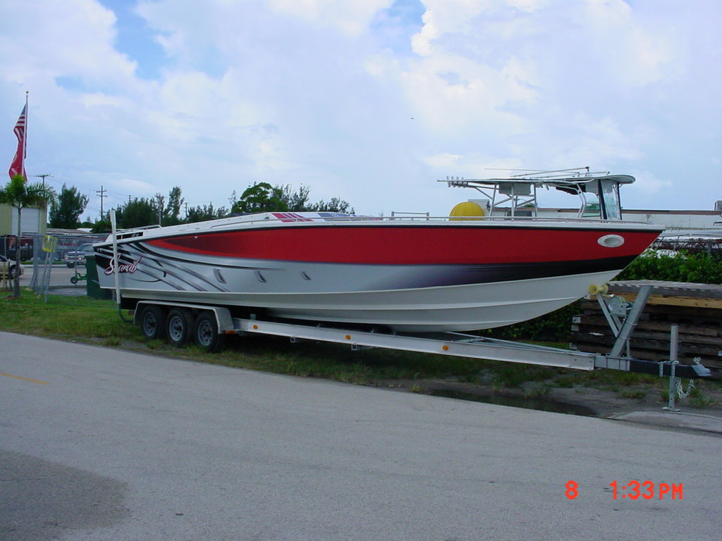

I just upgraded my membership now I just need to figure out how to attach a photo....
I've been working on her for about six months and seem to be making some progress.
Took her out on the water for the first time last Saturday and was pleasantly supprised.
