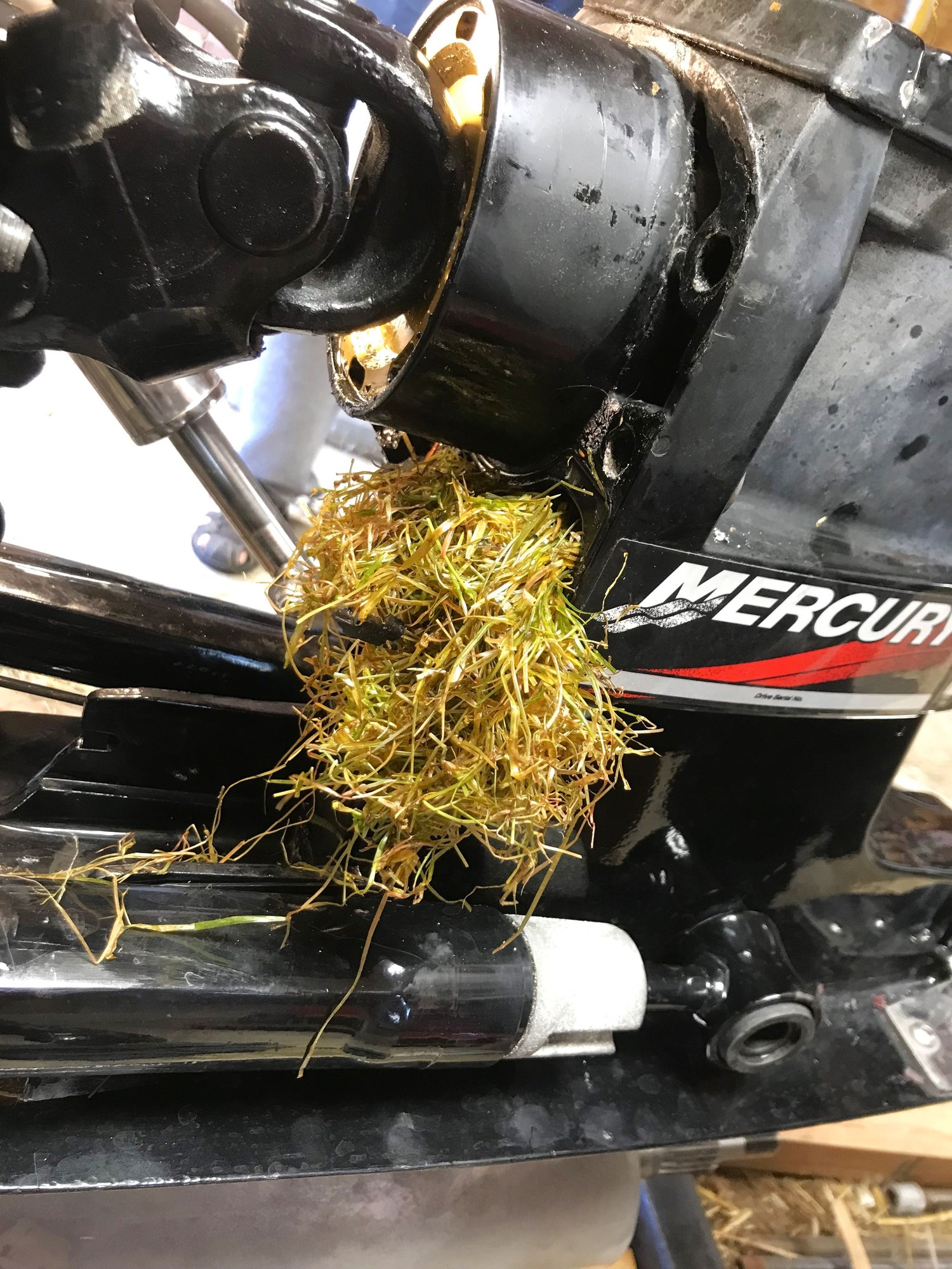

This is how I lost water pressure! Oh and the fuel in the fuel pump oil reservoir is normal so just change it when you change the impeller.
