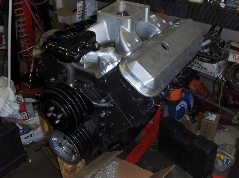

I have two intake setups:
1. GM alum dual planes w QJets
2. Weiand Team Gs w Holley Dominators
I plan to run the dp-Qjets with the 088's and stock cams this year to shake down the boat, and am wondering if I should spend next fall's money on valves/seats in the 088's or look to something else?
I'm open to suggestions for the cams - 28' Checkmate, dual Bravo, and I don't want to break any speed records...

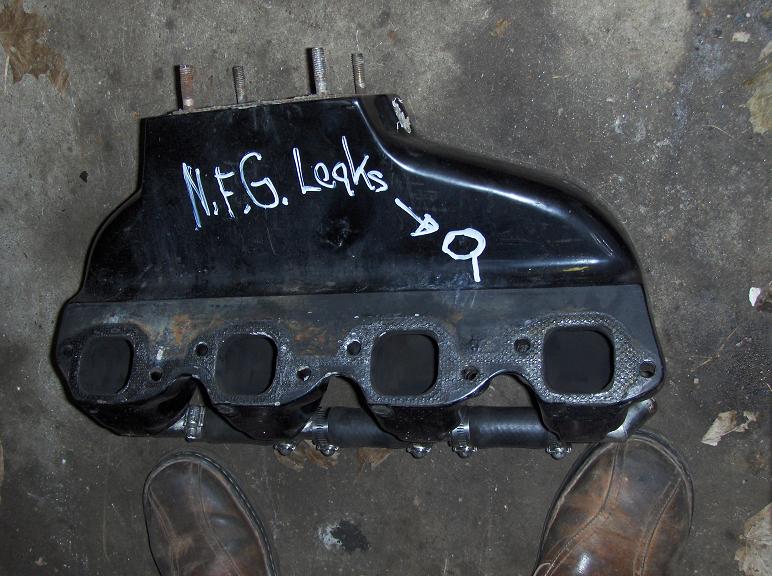

I was lucky and got my hands on three sets of Gils - one of older design with frost plugs, and two of new design - all pressure tested good except one of the newer ones has a small corrosion leak- I'm gonna try and plug it.
CHRIS - Thanks for your advice and help - much appreciated - you can see here the pitting and the width of the exhaust seat mating surface are pretty much done. If I grind them anymore, I'll be into the intake valve....
