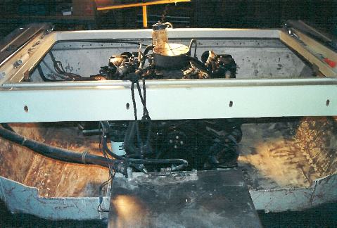

Checkmate, you could just lightly sand the engine compartment and gelcoat it. That is all that checkmate does, they use gelcoat that has "Wax" in it and brush it on. By using this type of gelcoat
you will not have have put air barrier on such as PVA so that the gelcoat will cure. I did the same thing with my checkmate when I redid the engine compartment. If I can find the pictures I will post them.

Old 03-10-2002 | 08:30 AM
Posts: 543
From: Sussex, WI
pic 1
File Type: bmp

Okay, i'm checking to see if this worked, and I don't know why the picture did'nt just come up, and when I try to down load it does'nt work for me. Is it working for anyone else and if it is what do I have to do?

Thanks Ron, Yes I see the pics. Although I don't know how you got them to come up like that.
I did'nt want to do any sanding. I still have all the wiring everywhere and 2 Kplane pumps and the drive trim pump and steering hardware. Yours looks great but I don't want to remove all my stuff like that.
