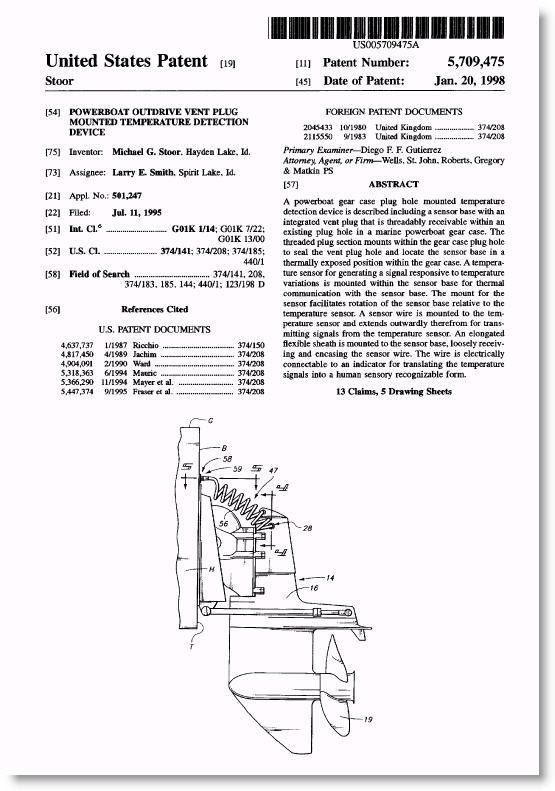

I looked into this a while back and located the concept in the pic below which was patented in 1998. I also remember an article published several years ago in one of the boating magazines evaluating drive showers and their effect on gear lube temperature. I can't remember the temperatures they were running, but I will see if I can find the article.
