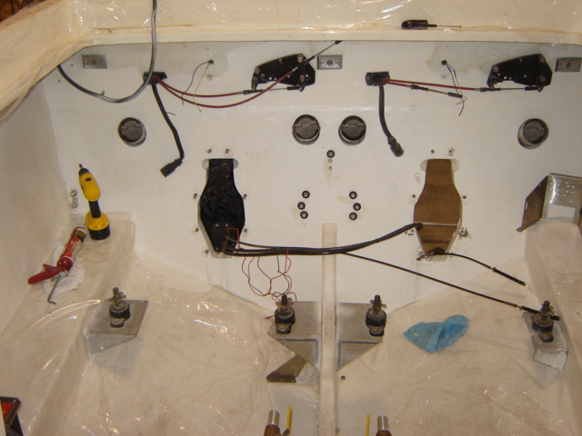

Here ya go Conquest. These were done with the Interlux Bilge Kote in white(obviously)
The first pic is a before in white gelcoat.
Attached Thumbnails engine compartment-38-stryker6-large-.jpg   engine compartment-38-stryker3.jpg   engine compartment-38-stryker2.jpg

Here is another before and after. You will not be disappointed if you use the Bilge Kote. Hope this helps, Eddie.
Attached Thumbnails engine compartment-envision-006-large-.jpg   engine compartment-envision-010-large-.jpg   engine compartment-envision-011-large-.jpg

Not at all. Just rough up the surface and either roll or brush it on. It's that simple. I like to hit the surface with 80 grit paper on a DA or orbital sander. Then wipe it down with acetone or similar and paint it. You will probably need 2 coats, depending on what you are going over. Put on one coat, wait 24 hrs, and recoat it. That is all there is to it. It will flow out great and not leave any brush or roller marks. It will look like it was sprayed on. It really is some good stuff. Hope this helps, Eddie.
