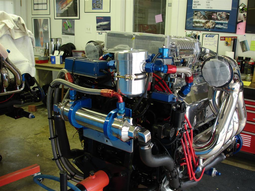

Mine have been on this bracket since 2003.I like having everything mounted to the motor, all self contained,you can pull the motor off the dyno and go straight to the boat,exhaust,water pump,fuel pump,oil and water system all on the motor just like it comes out of the boat,keeping it simple.I first made it in alum,cracked it in the tight bend, instead of putting a gusset to keep it from moving, I just made it out of .060 stainless, stays polished out better anyway
hope this helps
Rob
