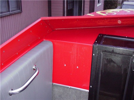

Okay guys here is what I have found in ansure to your suggestions to help narrow it dowm a little. Cord you are right on the money about no acess and the gas tanks being right underneath. I pulled a screw out and stuck a small wire in the hole to see how much room I have underneath and it is not much. Only about an inch and a half from the top of the bolster bracket. The screws are already #12 and there are 5 of them. I replaced the catpet a couple of years ago and there was no discoloration in the floor nor is there any soft spots. The floor is encapsulated. If I cut acess holes I would not be able to get at the bolts to through bolt unless I cut one hole next to each bolt and I don't think swiss cheese floor would be worth it. James I would like to see the info you have you can fax it to 586-786-9530 c/o Dave. Wildfire I will post a couple of pix of the faring so you can see what I was talking about before.

Does that last post at 100 make me a Senior Member? Wildfire here is another pic

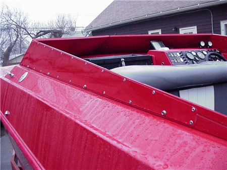

wildfire one more for luck
