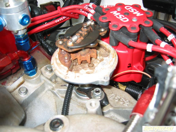

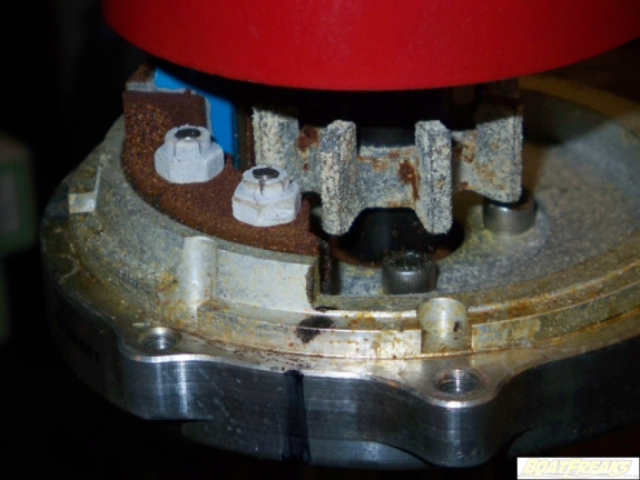

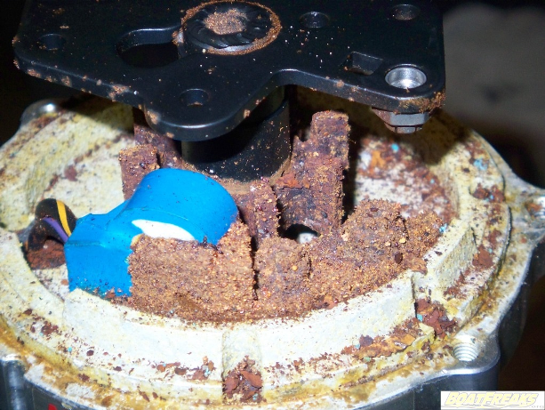

Ditto on the 6AL's ....3 years and no issues ..except one time while underway I told my wife to switch the Batteries to "all" ...she thought I said "off" !! Instant stop ....and it did fry one of the boxes ....... Scary part are the distributors ....have you looked inside lately? I dont see how they run after all the corrosion that builds up! The plan for me is to send the Distributors back to MSD ... I think its about 100.00 and they go thru them and replace all replaceable parts ...When I get them back I'm going to clear coat the insides ...m

yikes .....
Attached Thumbnails MSD..... marine or no..??-msd2.bmp   MSD..... marine or no..??-msd3.bmp   MSD..... marine or no..??-msd.bmp
