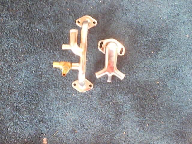

When you hook up the crossover, what do you do with the belt? get a different size belt for the -minus water pump pulley?

capo71- crossover off my 454 mag allready has pressure relieve if it fits make me offer.James
