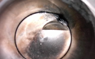

rebuilt engine experiencing blow by
Joined: Jan 2002
Posts: 230
From: south jersey
sorry to hear it. ouch. i think you blew a hole in a piston also. the gasoline doesn't have the lubrication qualities of oil and wouldn't stop your rings from seating in my opinion. even if they didn't seat yet i don't think a breather would blow off and enough crancase pressure to blow oil out, only a blown pison would. you may consider yourself lucky though because you didn't have a crankcase fire.

Heres an update as of last night. I talked with the engine builder and here's what he said. did a leakdown and compression check. all cyl checked out fine except for the #4 cyl. zero compression. I said to him hole in the piston? he said looking at the spark plug I don't think so. He's pulling the engine today. I will know the exact cause of failure thursday. It's ironic the EGT probe is installed in the #4 cyl 1250 is the highest temp I saw. in fact when the failure happened the pyro was reading 1150. stay tuned
The results are in.
Holes punched in the pistons. all eight # 4 and # 2 are the worst.
The guy who built the motor even though he didn't do the ECU remapping is going to help ease the pain.
It's now time to go see the guy with the computer and see what he has to say.

did you look at all eight pistons? they were all melted or cracked? did you happen to notice if any exhaust valves were bent. i've melted pistons all the way down to the rings before too but it was only three cylinders out of eight. all eight with holes is pretty rare. what i'm getting at is if your springs were too light it may have caused some valve float at high rpm's. just another possibility to look at. sorry to hear about your engine. that sucks. Fran
excaleagle42
Let's me explain it to you this way.
2,4, 1,5, with holes burnt through # 4 took the worst hit. the rest were about to go. JE pistons All in the same location the valve relief.
