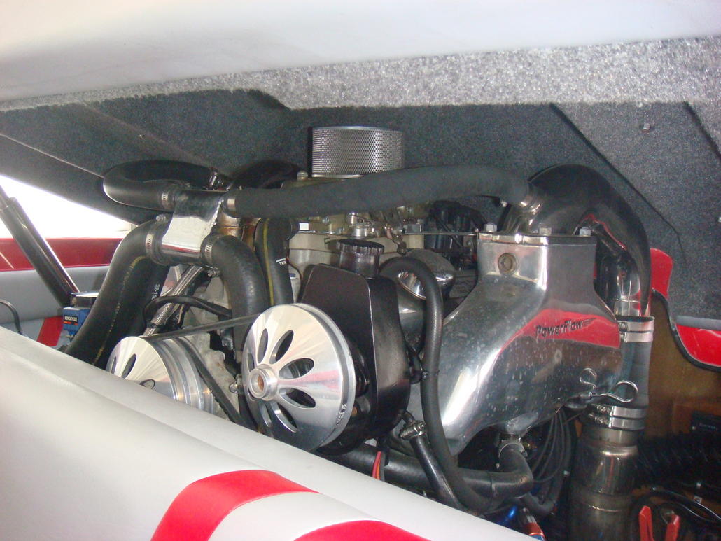

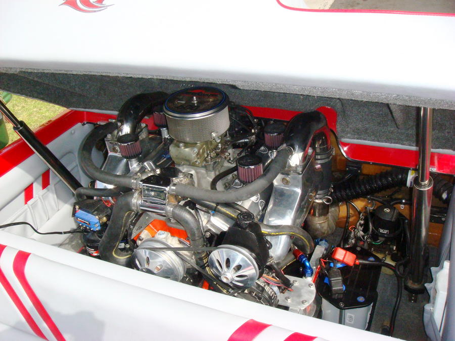

Let me see if I can get some picts of my small block- Im not running headers, but a high end manifold and i think it's going to be relatively the same.
UD
Attached Thumbnails Help converting to headers on a SBC-406.jpg   Help converting to headers on a SBC-last-roll-10.jpg

That won't work with the Stellings. You have a wet joint between the manifold and riser to transfer water. He only has one place for water to enter the headers.
