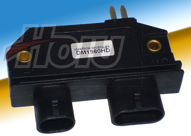

Does it look like this?
Ive been buying the AC delco for a 1995 Corvette,cap and rotor also.Mine is a 2001 500efi.
I have been having a prob with corrosion on the pick up coil plug,the 2 prong one.
Attached Thumbnails Question about ignition module-ignition-module-modules-gm-1989747.jpg

Before you install the new module go to a western snowplow supplier and get a tube of their dielectric Greece,it has rust and corrosion inhibitors in it and will stop the corrosion..
