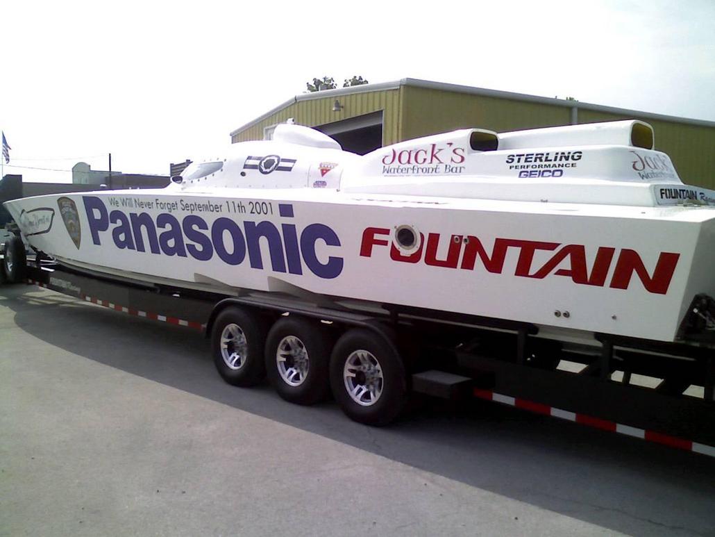

this is the one he put the pad on

Remember, one of the reasons for adding a pad to a classic (no steps) v-hull was to get it up and riding on the pad. With the advent of ventilated bottoms (stepped bottoms), manufacturers learned some hard lessons about the back half of their hulls. Many early stepped hulls were simply "too well ventilated" and would spin out with little or no warning.
Reggie Fountain went through many generations of steps before arriving at today's designs. These newer hulls do not rely on a pad to get speed, but instead the aeration provided by the steps. Hence, a classic pad on a stepped hull is generally not desirable. Could you add one and gain some speed? Maybe. Could you also totally screw up the handling? Maybe.
