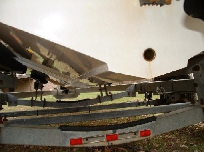

My old boat had a v-shaped pad. Look at pic2 and you can see that when up on the pad, the chines where out of the water at speed. It took a proper setup and some seat time to make it work. The boat was fast for size/power and handled great.
Would I try to build my own pad.....NO.
