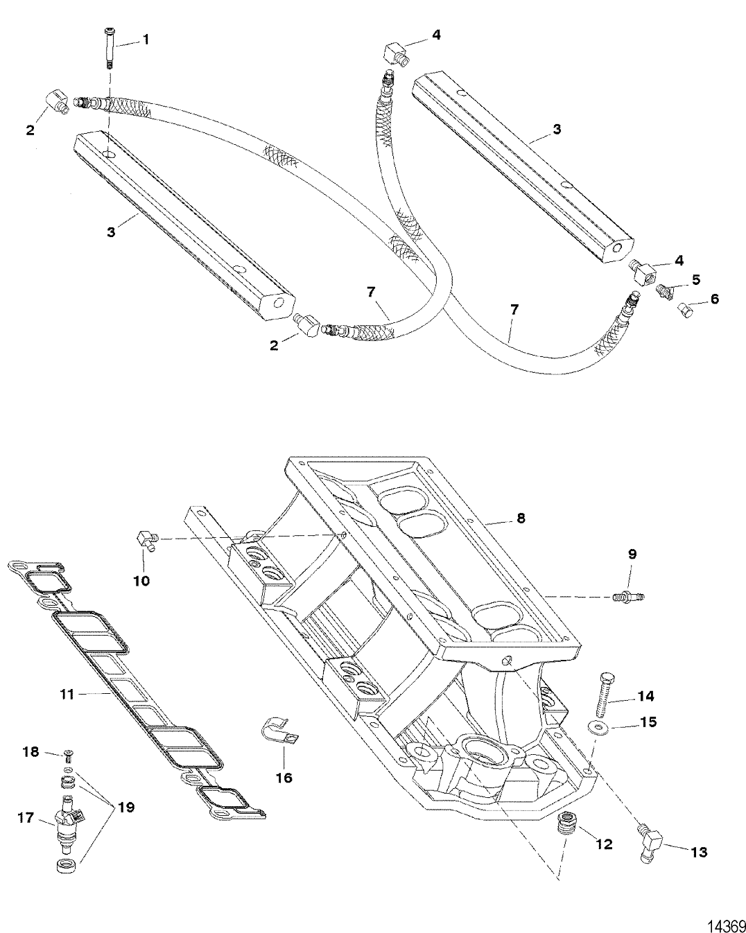

Eddie- Here is a diagram of the intake manifold and the fuel rails on the 377 Scorpion. Off of which one of these taps would a guy connect the regulator and return line?

Out of the pump to a 10 micron filter, then Y block , then one end of both rails, out the other end to the regulator, return to tank.
Tango,
Sorry I missed this post previously. As mentioned, just come out of the pump with a -10 line into a Y block. You should mount the pump very near the tank. You can run (1) -10 hose back to the engine compartment. There, split it into (2) -8 hoses, one each that goes to each fuel rail. Then mount an Aeromotive regulator and have one line come out of each rail and into the regulator. The return will come out of the bottom of the regulator. This will return back to the tank. Give me a shout if you have any quesitons.
