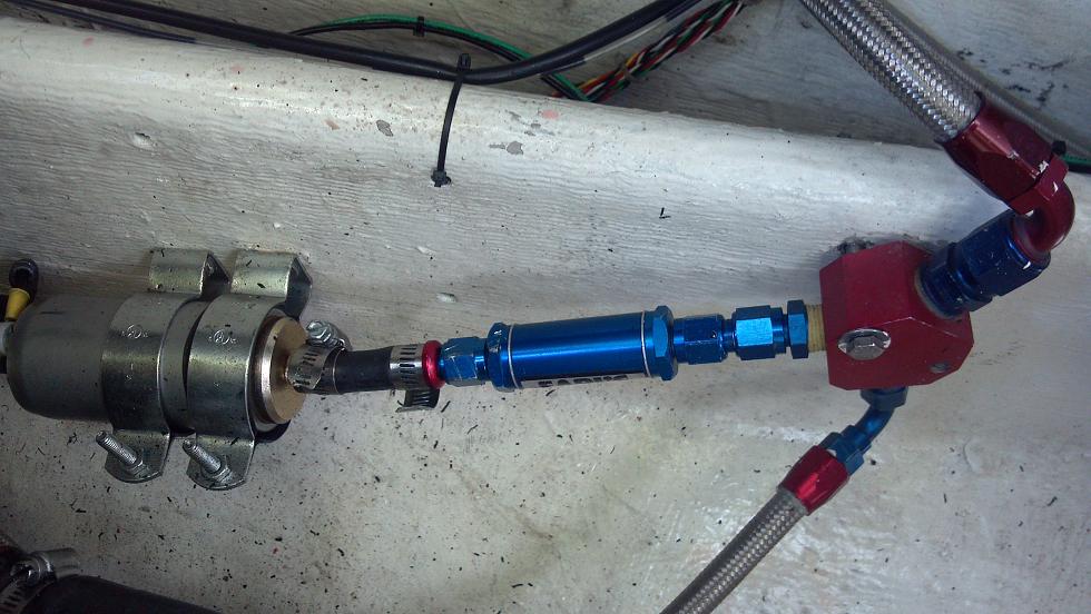

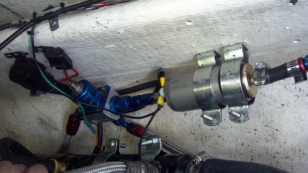

Here are a few pics.
One is of the pump and the regulator. Both are mounted on the stringer with the regulator being slightly lower. The return line is on the bottom side of the regulator. We have it set at 37-38 pounds.
Another pic shows the Y where the return comes back in, the filter, and the pump. The incoming fuel line comes on from above.
