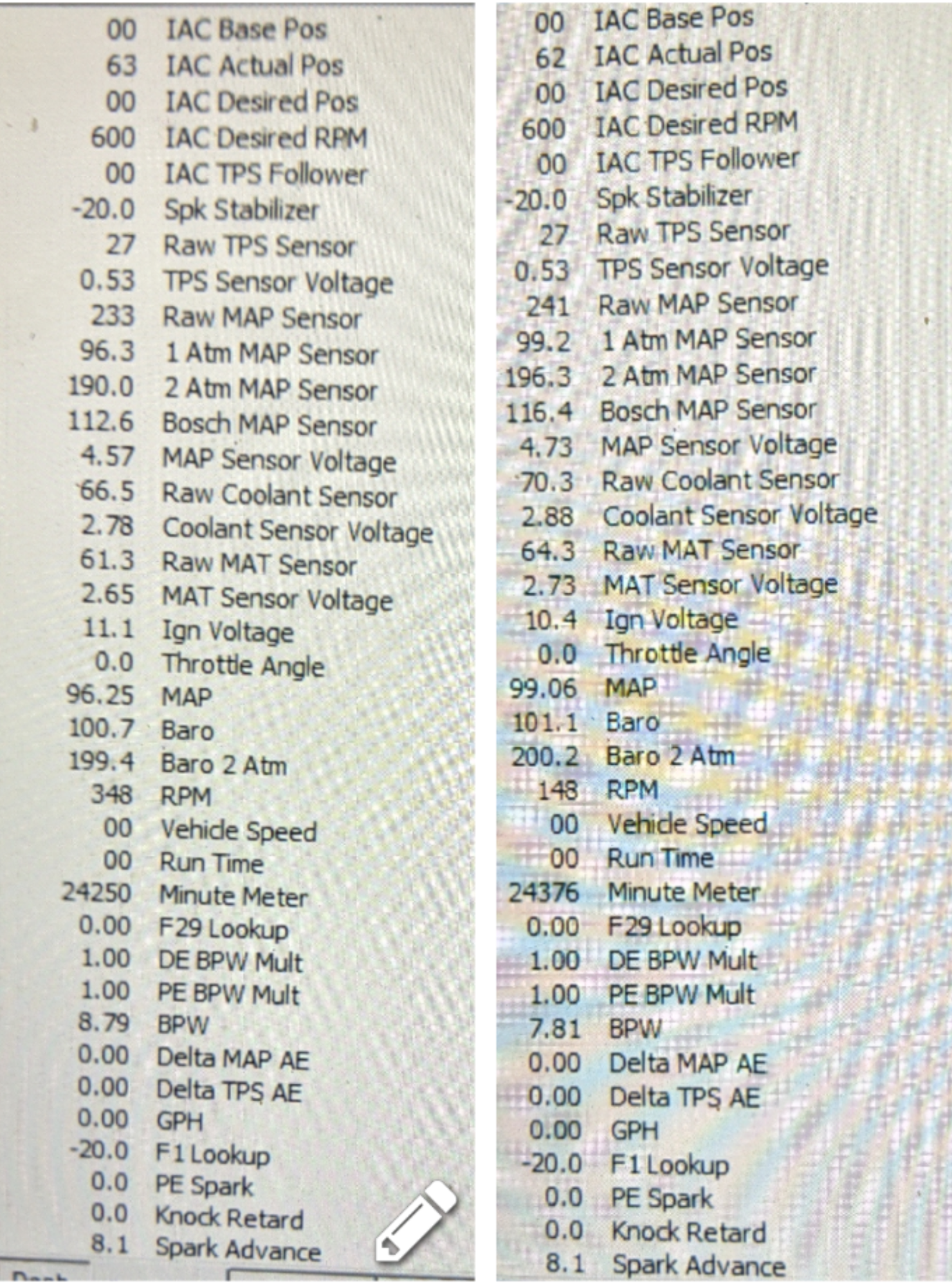

PS: Attached is a log from a MEFI reader. Good start on the left, bad on the right. I have checked all the cables for voltage drop since it is only spinning at 150rpm or so on the hot no starts. Cables are all good 1/0 & fairly new.

Cables, grounds & batteries all check out great.
