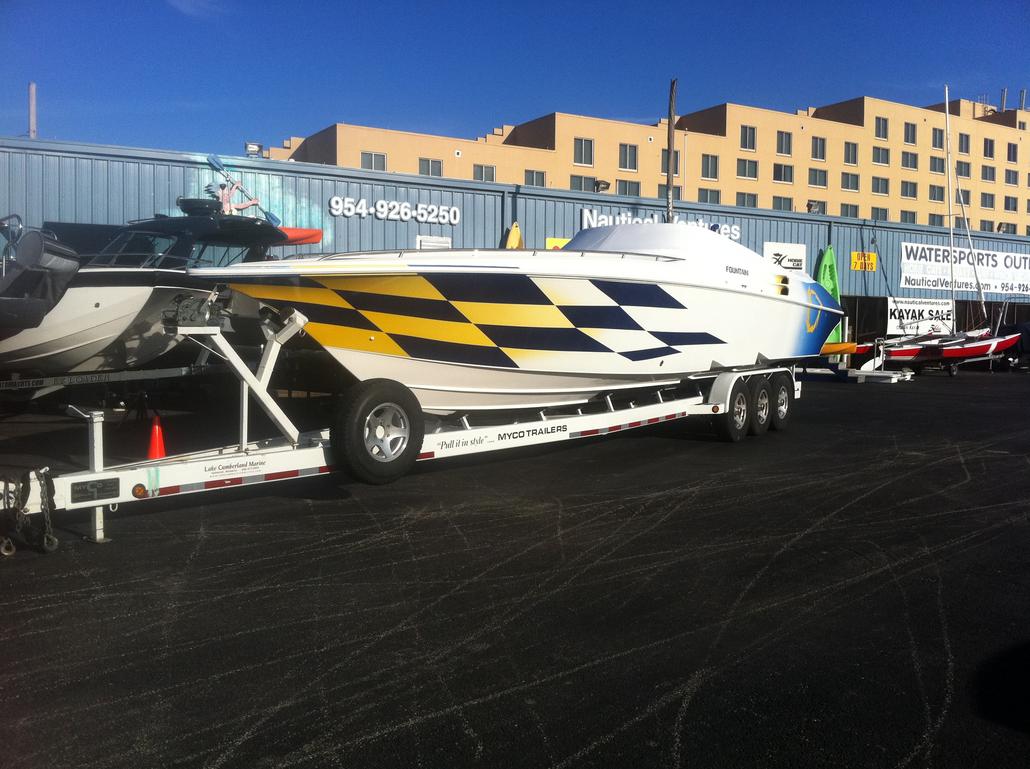

Here is the rest Kelly, wish it had your paint!

Old 03-04-2012 | 09:08 PM
Joined: Jan 2010
Posts: 297
From: North Bend Ohio
Attachment 469856
Attachment 469857
Attachment 469858
very nice 4bus. run them and enjoy. Is the red canister the power steering reservoir? Never seen that on a 575?

Old 03-06-2012 | 06:05 AM
Joined: Jul 2007
Posts: 3,648
Likes: 32
From: Oneida Lake NY
Thanks,
Ya it is the ps res, go figure they run a read one? all my others in the past have been blue

Old 03-06-2012 | 07:03 AM
Kelly O's Avatar
Joined: May 2004
Posts: 1,263
Likes: 21
From: Auburn, New York
Ok, now I know what boat to watch for on the water. Have not seen that paint combo before, looks nice.
