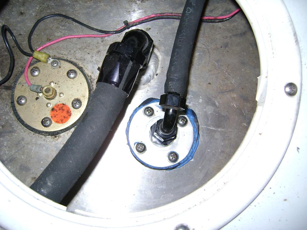

The other option is to add another fitting into the top of the tank like I normally do. Here is a pic. The rubber gasket on this one sqeezed out a little since it was overtightened. This one doesn't look that great but it works.
Eddie.. I like both those ideas, gonna go check that out now...
I'll call you to see if I can get fitting from you. Concerned with metal shavings a little though. Wonder would that be big enought for twins or would I need (2) of those tank fittings?

I run twins so I needed 2 ports.. I have decided to go to the main fuel fill line since its 2" and as Eddie Young shows CP has a connection for this with a bung already on it.. I'm adding another so shouldn't be to hard to install.
