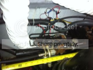

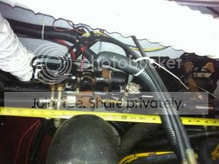

Thanks TCH ! This is what I've been looking for. My problem is, still, I need to make sure of what other type parts will work in this application. Here is a couple of pics of what I have now. I know it looks kinda ragged, but that is why I want to replace it !!!

We had to do one on a Baja once, be careful, the older style, and the newer ones have different size fittings, and do not interchange, unless you change the power steering lines along with the actuator, or find some type of fitting adapter.

you have the early style, they are $$$$, replace with the later, much better and cheaper, probably have to change the 2 hoses if yours does not have O-ring style ends, simple change over....

You must change the hoses. hard to adapt with over the counter fittings from hydro shops. I spent two weeks and 50.00 ordering and buying fittings to rig it. Wound up buying new hoses from merc. $$
