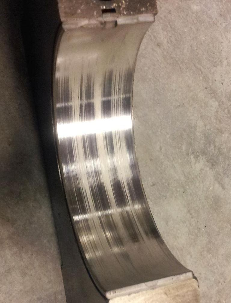

First thing I did was pull one of the main bearings (#2). This is what I found:
If you look closely, you will see that the bearing was burnished shiny. No real grooves that you can feel with your finger. Fortunately, the crank journal does not appear to have any damage. I will obviously have to pull the rest of the rods and mains to check them, but it is obvious that some very fine grit apparently went through the motor.

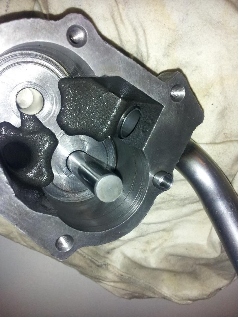

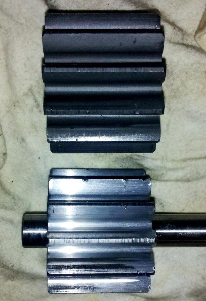

Pulled the oil pump and opened it up, and found this:
It looks like some serious trash went through those billet gears! But where did it come from? The screen should have picked up anything big enough to do that kind of damage, at least in my thinking. I will check the valvetrain out very closely to look for signs of needle bearings coming out, but I may have found the culprit:

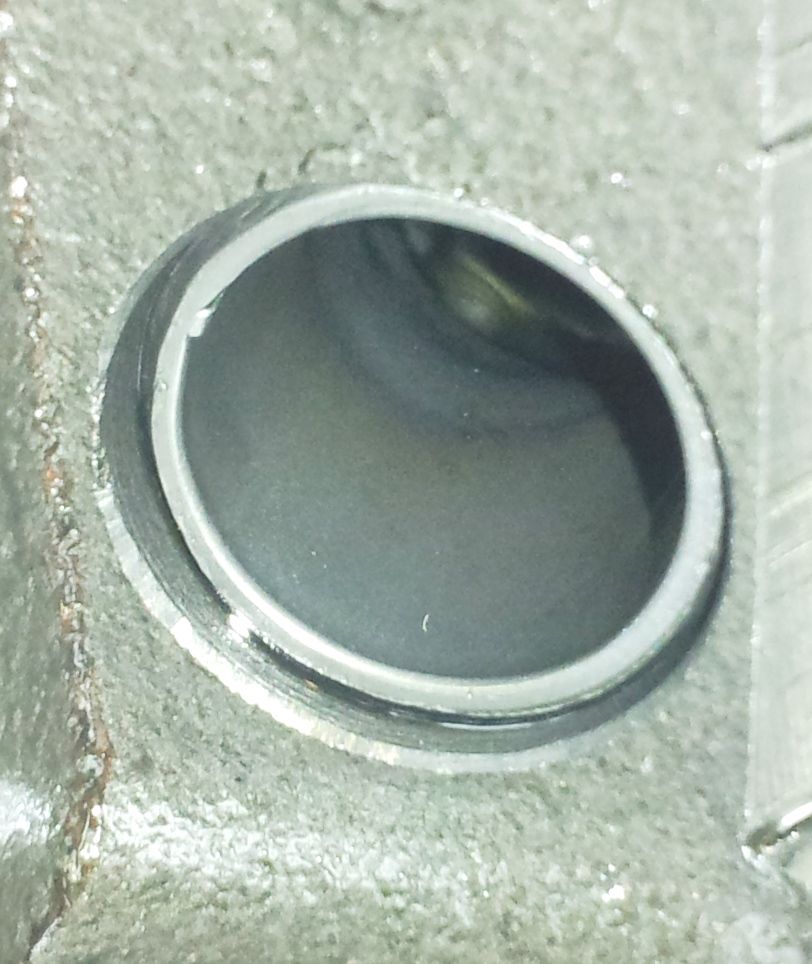

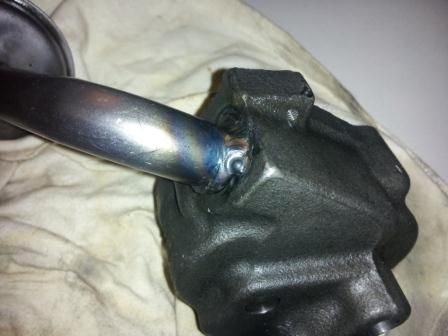

This is a closeup of the inside of the intake port for the oil pump pickup. If you look closely, you can see an area where it looks like the weld may have burned through. Right now I am wondering if a piece of slag developed there and broke off. Here is the outside of the pickup welded to the pump:
That is the best theory I can come up with right now, and it would explain all the wear on the distributor gear. However, I am wondering why the oil filter wasn't able to catch all of that stuff. I cut open the filter from the initial breakin as well as one that had about 20 hours on it (also documented in another thread). Here is a shot of the inside of the first filter:

I don't think the weld is your problem. That looks good to me. Just a nice full penetration weld.
Nice documentation. Good luck. I'm betting that something somewhere wasn't clean and the debris was in the engine at startup. Keep us informed.
